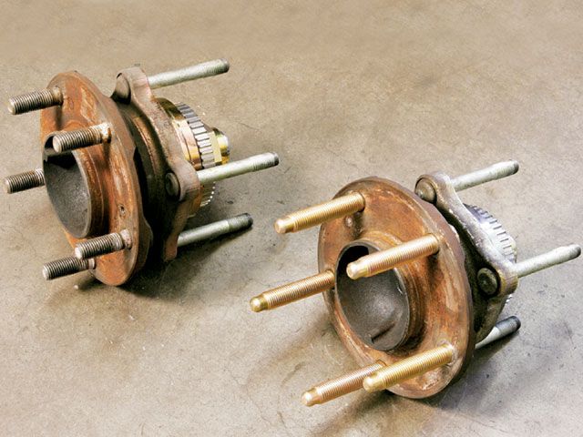

That is why you need longer studs. In my picture I am showing you the short and long studs. With the long studs then you have more area to screw onto. 3 rotations is too little.....:driver:
