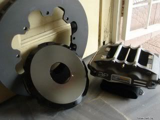

Introducing:
AP Racing
-4pot caliper,
-Wilwood rotor,
-Willwood hub and
-Wilwood brake pad.
Price: RM5500
*The hun is brand new and never drill. So u can drill the pcd that u want.
*This is universal kit.In order to install at Lancer/other car, u may custom a adapter to mount the caliper to ur knuckle.Easy job!!!
All Brand New!!!
[/QUOTE]

Introducing:
AP Racing
-4pot caliper,
-Wilwood rotor,
-Willwood hub and
-Wilwood brake pad.
Price: RM5500
All Brand New!!!
[/quote]
iyo...u dont hav used 1 ley....
too pricey for me lah...
