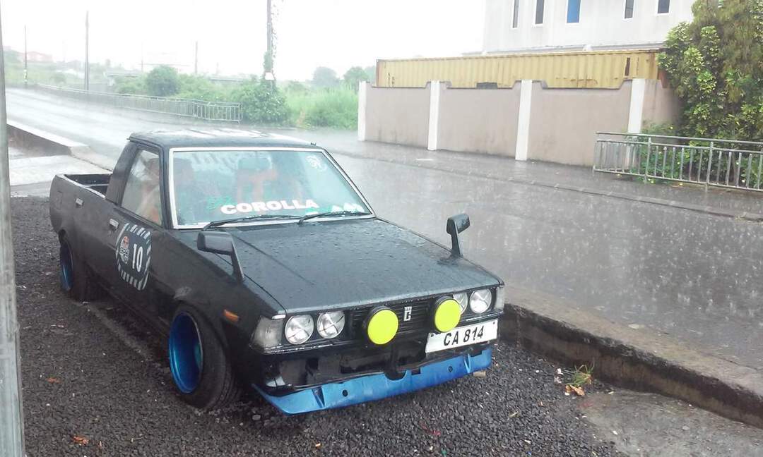

I have a toyota 4age silvertop,.my problem is high fuel consumption,i recently swap this engine on my corolla KE 72 wagon to pickup conversion,and i'm having much trouble with the engine..

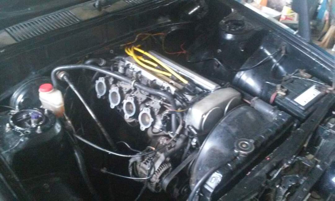

In the begining,i ran on stock engine,but later i tried to disconect the air flow meter,and not having much diference on engine behaviour,so i remove the intake box and let it run on the ITBs like blacktop,.
The engine runs well without the air flow meter,but the fuel consumption is still high..

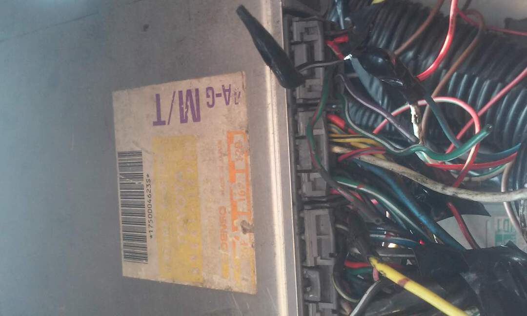

With faulty or no AFM, the ECU must be fueling maximum all the while, that is why high FC and plenty of soot and carbon....
