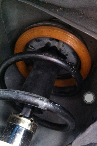

Bro, if you're in KL, you can send your car to our Airtreker's mechanic, Ah Wah. He certainly can help but since you're in JB, a bit difficult. By the way, my other car (Nissan Sentra N16) has this problem too. Apparently, it's the bump stopper which is essentially the rubber/hard sponge thing that mounts near to the top of your absorbers to prevent it from bottoming. Check that part of it's spoilt.
Alternatively, check our absorber's top mount 'plastic bearing'. It's said to crack easily but the noise will only appear if you steer your steering. Hope these info is helpful.

if really the platic bearing,just turn left n right u will hear the sound.if brake hard or go over bump there is a tak tak sound is your absorber gone edi.it happens to me too,dun bother it much.new shock cost 3k,find h/cut 1500+service alsmost 2k.

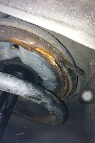

Oh yes, just reminded me. When I brake hard, I get the tak tak sound last time too. This happened after I slot in the 4 pots caliper.
Apparently, it's because of my springs. I am using Eibach and in original, the upper and lower coil portion has a layer of rubber on the spring. This is to prevent the spring from any noise if we brake hard enough, where the circles of the coil hits each other. The layer of rubber cracked.
So my mechanic took off the rubber layer and replace with water pipes. Yup, cheap and it works!
That's a great fix!! I like it!!
Simple, cheap & problem solved :)

bro, what do you mean by "lol...all ur car mod very cute leh."... this is not cute. This is innovative and it's Ah Wah's mech that solve my problem.:confused:

bro,metal rubber metal.sooner or later its gonna eat a hole in the rubber hose.the problem same as the plastic bearing on top the mounting.i was told using sport spring wut so ever brand shorten the life-span of everything on ori shock,bushing,bearing,mounting.either go ori change whole suspension same branding.

Bro, anything that is moving, will have wear and tear. Even stock engine rubber parts last you the most of 5 years. Adjustables are much better for sure in terms of handling performance but it needs servicing and replacement of rubber seals, etc too.
I'm not sure the cheap/cute rubber hose will last me for how long but I know at least for the next 1-2 years, it'll be problem free for me.
