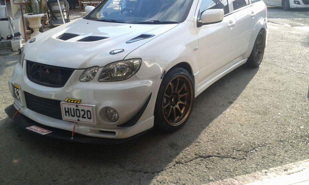

Went with 18x9.5 5x114.3 now just trying to figure out the best way of putting rear brembo brakes on might need some help from you guys on this lol

Hi Jesam,
Would really like to see the pics of your wheels. what offset did u get for the 9.5JJ? I have also installed brembos and need to get new wheels. Was thinking of 18 x 9JJ With an offset of 30.

Hey 18x9.5 5x114.3 with 30mm offset and all so have 20mm spacers but my advice is to try before you buy just to make sure they fit
Offset 30 with 20mm spacer become like offset 10 but your rims still not really out from wheel arch?:smokin:
Hi Jesam,
Thank you for the info. Unfortunately I wish I could test before buying. I am in Kenya and buying rims from UK. So have to check and re check all details before buying anything. Your info helps alot though.
BTW what rims are you using? Th wheel spacers did you use them to clear brakes or suspension?

JR wheels jr5 18x9.5 5x114.3 they will fit standard brakes but if you have brembo on the front you will need 6mm spacers just for the front the back wheels fit no problems with or without rear brembo :smile:
and don't forget new wheel nuts
