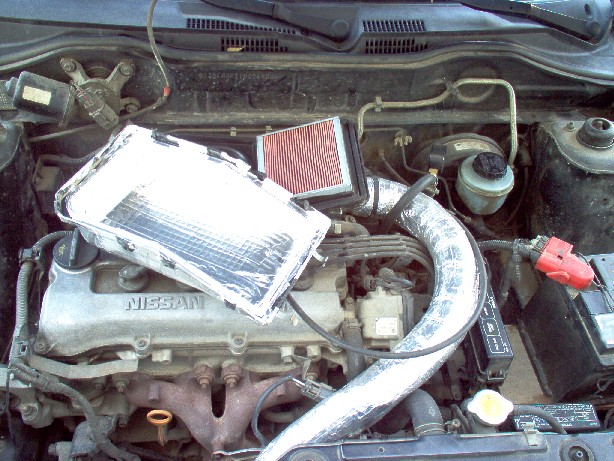

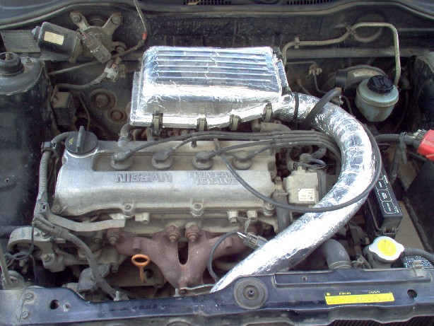

This is a simple mod that you can do to every stock micra.
You will notice a better response and better acceleration.
Parts needed:
Aluminium tape
+- 1M of 60mm flexible paper tube.

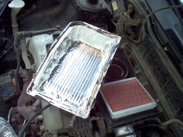

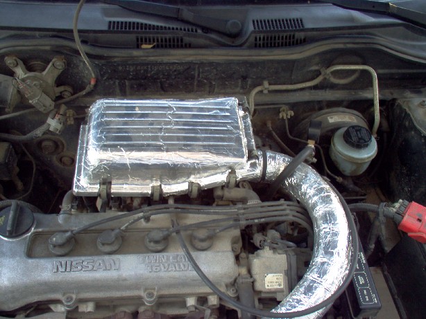

1. isolate whit aluminium tape the air filter box ,in and out, this will create colder air box.
2. extend the flexible tube to the front grill , take him out and isolate whit aluminium tape .
3. that’s it!
since aluminium tape as heat reflector properties the inside of the air box and intake tube will be colder than the outside

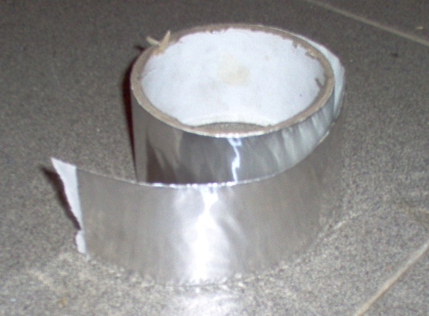

Where to buy the aluminium tape and how much?
Go to any hardware store & ask for aluminium tape. The one tat for stick/cover up small hole on metal pot, frying pan, periuk purpose etc... I guess, coz used to saw tat thing before in a hardware store. I asked the tauke what's the purpose of that tape.. Hehehehe.. :D

wrap extractor ah? no point lah.... this is not really heat resistance tape right.... if u want to wrap the extractor.... you might need to get the special extractor wrapper....
