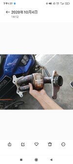

IMO, replace better than weldLater got time will go and ask can it be weld back by add some metal plate.
Worst case might need to change the front frame I guess?
The crack is likely the source of your noiseJuz wanna ask is driveshaft is a common thing to rosak?
Driving my car few day and hear some weird noise while going through rough surface or those zebra yellow line.
driver side have sound kak kak kak kak kak while going through the yellow line.
Appears to be previously welded/repair. Better just replace outright. Not that expensiveActually, if can grind down to bare metal, see where the rust spread, need some rust prevention paint also, just spray inside, weldable paint too. If not, just cut and match, bend some good steel and weld.
Buying is quite cheap,weld balik is the expensive part. HahahahahahaAppears to be previously welded/repair. Better just replace outright. Not that expensive
Go potong shop to look for one
Bear in mind your engine sits on this. Next, try imagining it giving way when you are on the highwayBuying is quite cheap,weld balik is the expensive part. Hahahahahaha
Nope, yesterday we found out really is the driveshaft. Driver side one.hahahahahaThe crack is likely the source of your noise
Will gocand survey 1st what is the price 1stBear in mind your engine sits on this. Next, try imagining it giving way when you are on the highway
I am unsure if that's the same piece. Need to ask the workshopWanna ask If I buy this and weld back better or buy a 2nd hand frame weld back better?
Yes, buying part is cheap. Welding it back is expensive AF. Around Rm500+/-Wth buying so cheap, just buy. Labour expensive i guess? If theres a lot of things to remove
