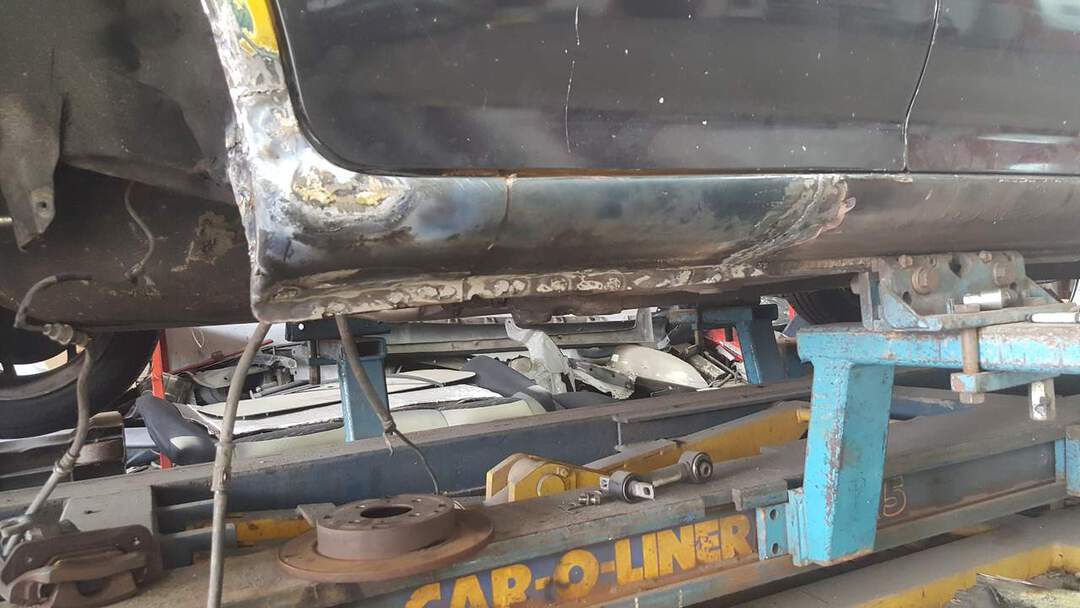

Old thread, but the last paragraph caught my attention. I more interested on chassis welding.
I not into wira evo convert, i already put 93t.
Since i in penang, set aside foam thing.
Sometimes lepak at pomen workshop, always hear koyak here and there. Chassis welding will improve or lessen koyak koyak ? sifu pls give comment. :adore:

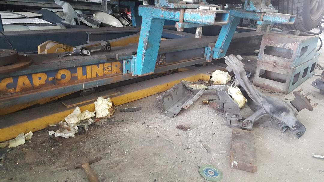

dont even bother with welding...
foaming, make sure its done properly and it's alright i guess..... keep in mind, it's an irreversible process with its fair share of pros and cons.
pro: strong (played with excess foam before, for the most part i guess it does the job
con: in an accident, the chassis might not give way as expected by the manufacturer. The car feels harsher, messy and not easy to clean up. Also, makr sure you know your chassis well, any wiring/drainage might get buried or blocked. In some cars, the door switch is located pretty low down, in my case, this cable got buried... its fine while it works but one fine day it snapped.... and it was an absolute pain in the arse rewiring it.
