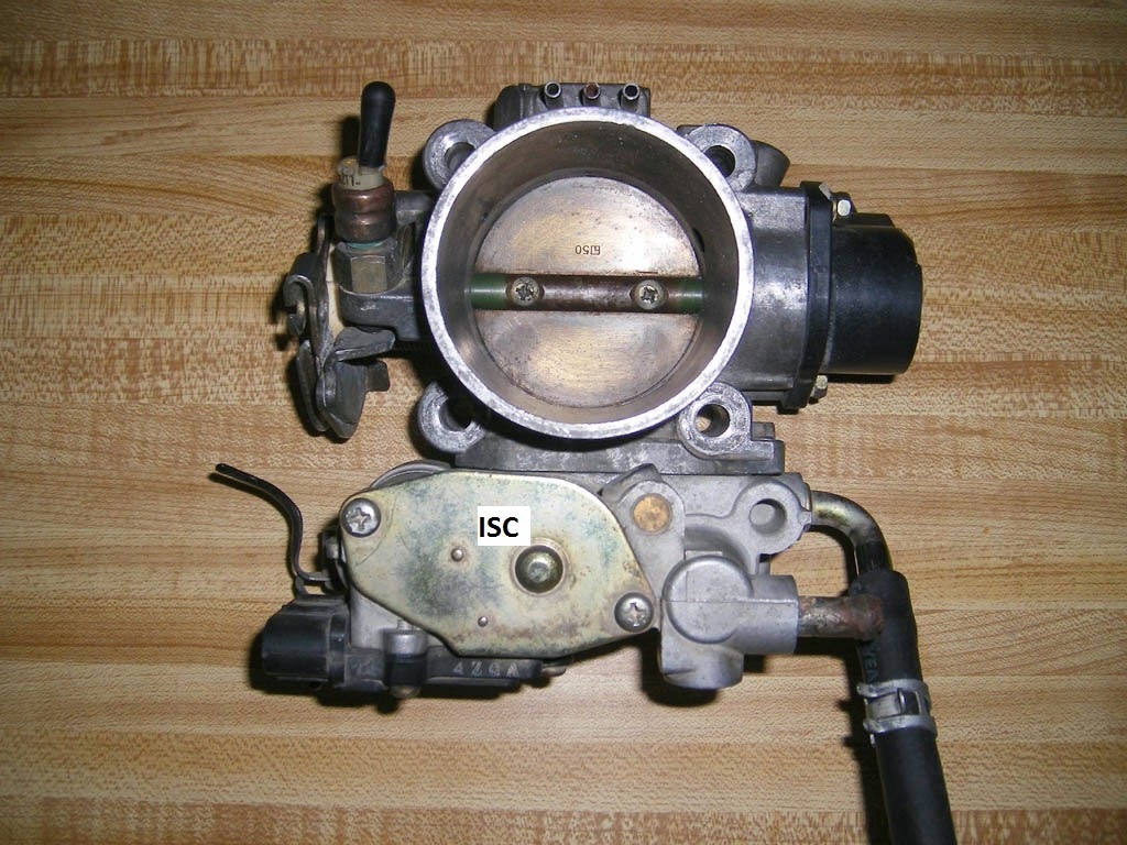

btw..can TB clean with grease remover such as solvent ?
Depends. Most degreasers and solvents are oil based. Siemens VDO TB has some sort of sensor there right? I can't remember. I just know it'll screw up big time if clogged. Just make sure it's not oily after you clean and it should be fine. I used to use this CRC solvent to clean, very the keng chau. Very the bad for the environment too. CFC based.

mine is not oily type 1 ...once i wipe it on some surface ..wind blows it ..will dry itself in 2-3 secs ...so this solvent would not be harmfull right ?

Yeah, like damone said - alchohol based solvent is the best.
Darren, try to look for "Throttle body cleaners" from ACE hardware. I usually use those alchohol swabs to clean my tb. I never take it out of place to clean so space is very limited.

take out da TB then wash off all carbon deposits with petrol and u need screwdrivers to scrape off some which are hard to remove using petrol....
no nid spray :stupid:
