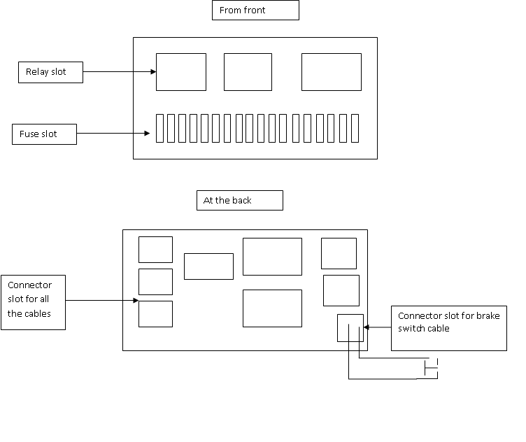

rough diagram from my observation of the fuse box front & back, later i'll post where the hell did I get this. from the observation inside the box there is still circuit that determines where the cables should be. in this case for brakes, the switch cable connector is indipendant (that means 1 connector slot just for it). than the signal is translated inside the circuit & delivered to the brake lights. so if my observation is correct, it might be the fuse box itself that's need to replace. so it should be plug & play & that should be easy to do for try & error. if still occurs than it's strip to the bone method oni can find shortage:bawling:
