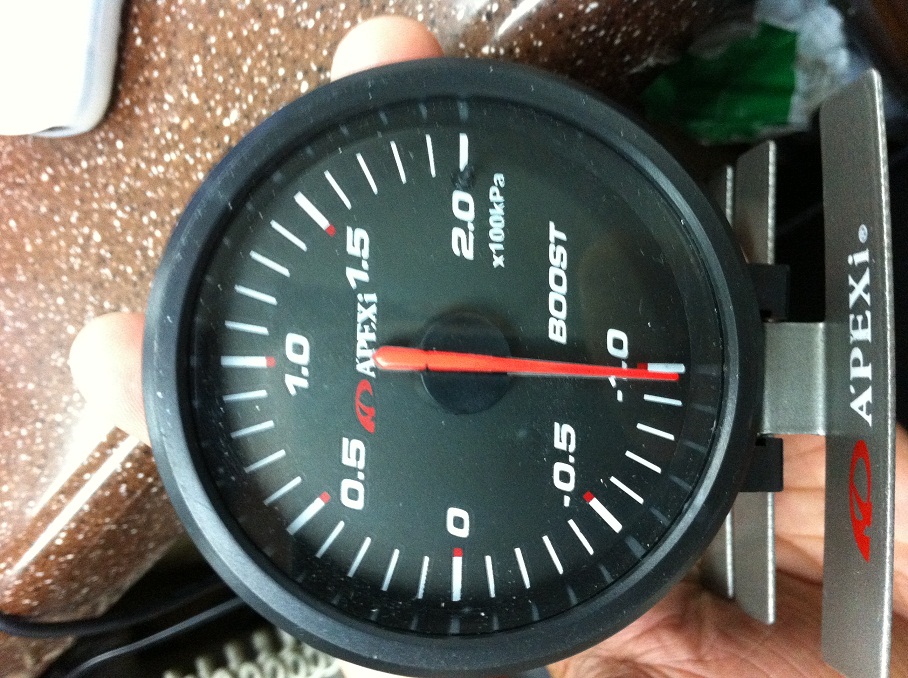

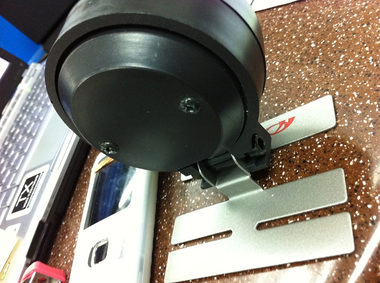

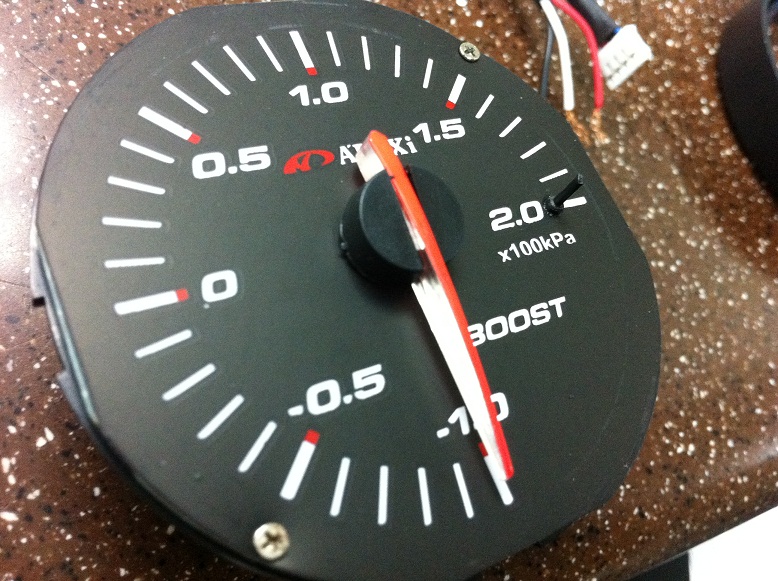

Dear all 0-100 Otai2 & forumer friends,
I just bought an Apexi EL2 Boost meter from someone that claim it as ORIGINAL gauge. After some closely spot, I doubt about the authenticity of this meter. Bad finishing, low grade plastic, non quality fitting & etc. Here I attached some picture for all of 0-100 members make some verification on this APEXi EL2 Boost meter. :bawling:
I really2 appreciated if someone can help me spot the authenticity of this gauge. Please help me :adore::adore::adore:

how much bro? i dun think its ori one..new ori apexi el2 price above 430...if the price below that, it might be fake one la..

u have been conned. that's immitation bro...
Yes bro khoyos, I confirmed with 3 performance mechanic & installer shop somewhere in my place. They guarantee this is absolutely imitation/fake APEX'i EL2 . So.....sad :bawling:

Rm350 each bro. I bought Boost, Oil Temp & Water Temp. BUT WHY HE SHOULD CLAIM IT IS AS GENUINE APEX'i? Why can't this %^&*& seller honest with buyer? I know the ori price around RM4++ but since he GUARANTEE that this APEX'i gauges are genuine at this price, I surely believed all Malaysian racer maniac fellow will buy at this price right?

The meter confirm immitation 1. I think u paid 10X than market price. I think Mudah got ppl sell about RM35 each. Danz perhaps some ppl just don't like Defi or too expensive.

first saw the apexi printing at the bracket already suspect it was fake one :biggrin:

One more think to add if the meter is electronic meter it sure come with control unit if it is analog meter does not have back cover.
