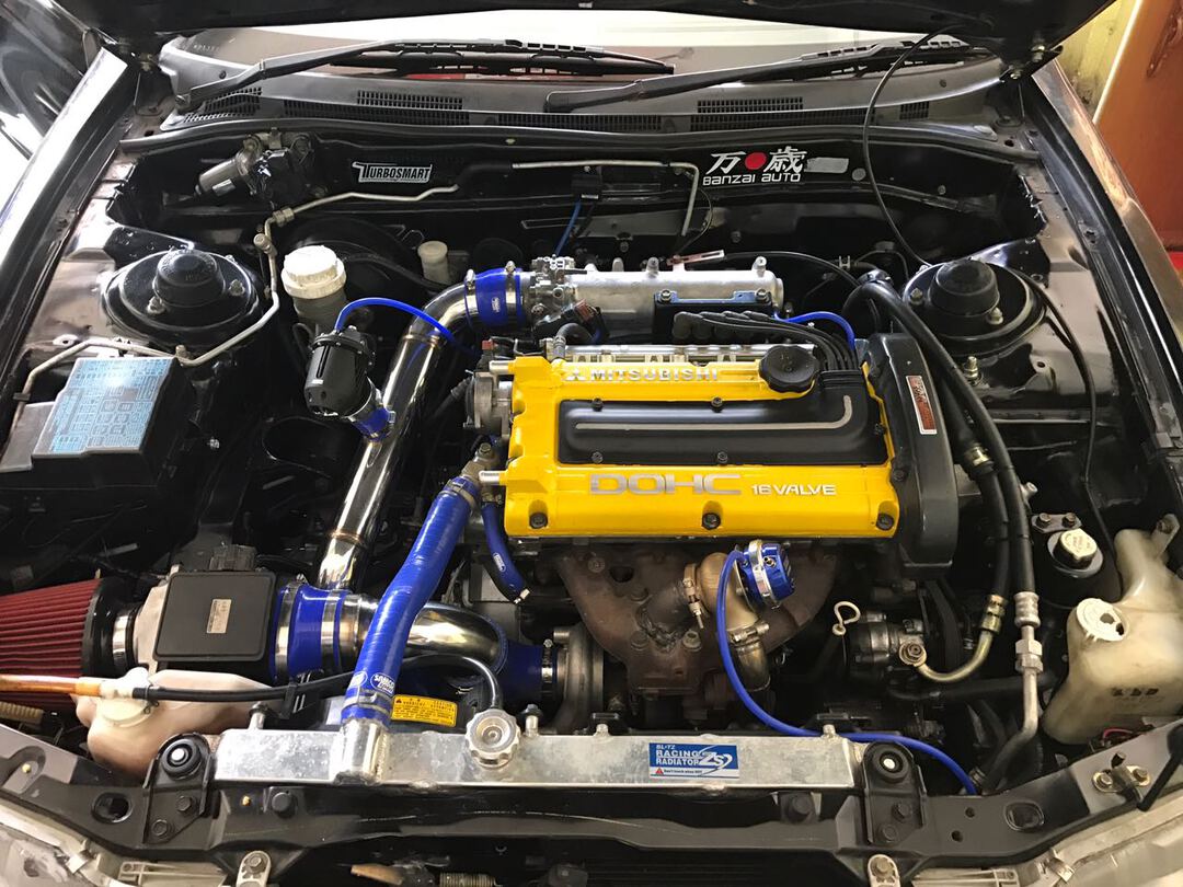

Hi sifu/otai2,
I'm a late come to this pv6 due to funding and studying. Hahaha
Now after 2 years working manage to grab a piece from discontinue mitsu legacy evo3.
I've plan to have it 300whp daily driven / drag(during event) pv6 car with stock internal and turbo. I hope to get some input from experience user and share some knowledge to those who are new in turbo car.
Hopefully som1 can pin point the weakest link in this build.
FF Evo3 transplant Pv6 build:
Handling/braking
-twin pot pajero front and ventilated + large rotor front and rear.
-ps3 215/45/17 tyre all around + bendix pad
-UR bra front top&bottom and rear bottom
-zerone 32step adjustable hi/lo/soft/hard
Potential Upgrade:
4pot front 2pot rear brake
Engine:
-evo3 engine stock injector, fuel rail ,internal, turbo tdo5 big 16g, gbox, oil cooler
-38mm waste gate
-bov
-FMIC stock evo3
-OCT
-evo3 ecu
-2.5"piping from exhaust manifold till muffler, muffler 3"evo6
Upgrades:
-fuel regulator Done
-fuel pump avs or DeatschWerks got avs unit
-Link G4+ ecu / haltech stand alone (most probably second unit)
End with repaint my car..hahaha
Thanks in advance
