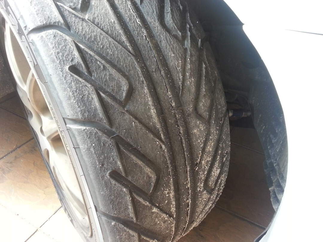

Noted bro, but did u adjust the tyre pressure after few laps? Because normally pressure will be up by few PSI after few lap run, is the excessive wear is due to pressure too high?
Last time my tyre wear out very fast cuz i did not adjust the tyre pressure, only keep pushing lap after lap.
