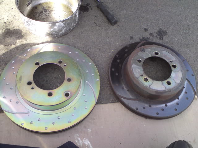

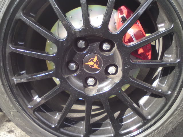

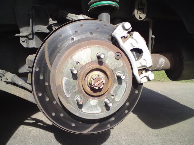

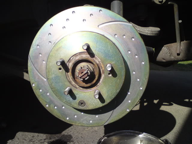

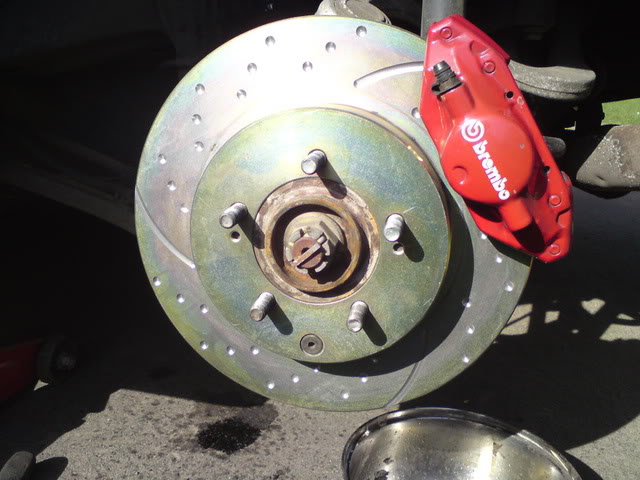

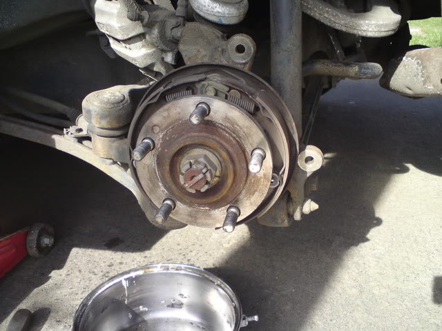

Q3--from ur mention, u have complete rear rotor from e4......mean ur have drum brake inside ur disc is it.....if like that u only plug and play ur e5 rear brembo on e4 rotor....i attach some pic e4 conv rear e5 brembo..

wut viper5965 mention is true..but peterj rear 4wd system was from evo3 right?yes he can pnp those e5 rear brembo brake directly to rear rotor from e4, i think need to 'kacuk' rear e4 knuckle with rear e3 knuckle,or maybe jez need to change it(honestly,i dun hv any experiences on dis)..then only can fit, if not then jez like AlucarD says..hv to use everythng from the e4,arms,knuckle,hub,etc..which is out of the story for peterj..
