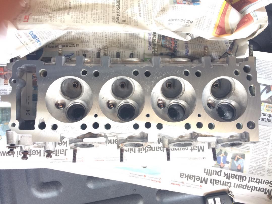

Update;
Valves are grinded, carbon cleaned and sent to be resurface...All too shiny, belong in a display cabinet;
Cost RM30 to resurface.

Your work better then sending to mechanic.......:driver:
Well the engineering shop must do as much as they can in a day...its income for them.
I really wonder why my bro send it to be resurface as i know its in good shape and only the gasket residue needs to be removed. He cant wait for engine start up maybe.
Yah! if only top overhaul no need resurface, unless overheated.....lol
