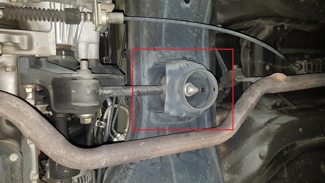

Hi Izso, mine is Myvi as well, may i know how you use the floor jack to jack up a the car, at which point you jack it up and put two jack stands at the pinch weld supports (behind the wheel as your picture).
Can I use floor jack to jack up the spring support underneath(the big spring support the tyre and car one)?
and what grease you using to lubricate the caliper pin?
Thanks :-)
i'm not sure which part you're referring to. I jack it up on the flatter stronger chassis parts of the car. If i'm not mistaken the pinch weld support is the original car jacks jacking spot right? that one bends using a floor jack so i don't use that bit.
Thanks for reply
What is mean is the Yellow color part, can i use the for floor jack point?
How about the Red color part?
Wondering where is the flatter stronger chassis parts you refering to ?
and i plan to use the "Super high temperature Red Toyo grease EAJ 8000" as shown in picture for my Myvi caliper pin, have you heard about it, is it suitable?
