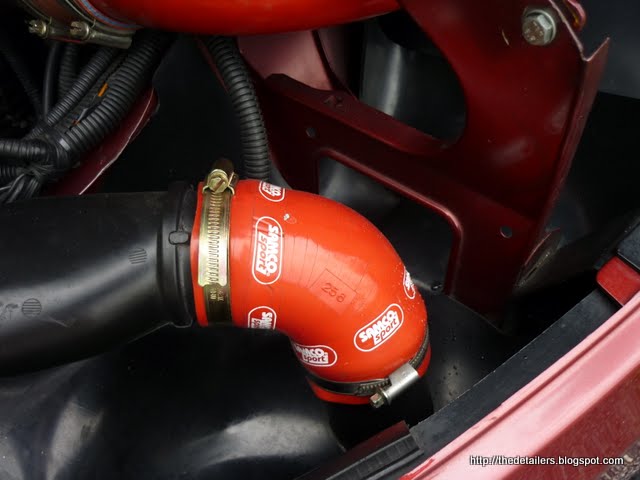

From Samcosport:
Q: How should I clean my SamcoSport Hoses?
A: SamcoSport only recommend using hot soapy water to clean your hoses. If you do this regularly, the natural shine will be promoted. DO NOT use petrol or any petroleum based cleaning products (including those labelled as Silicone shine or similar) – whilst these may give a short term shine, over time they discolour the hose.

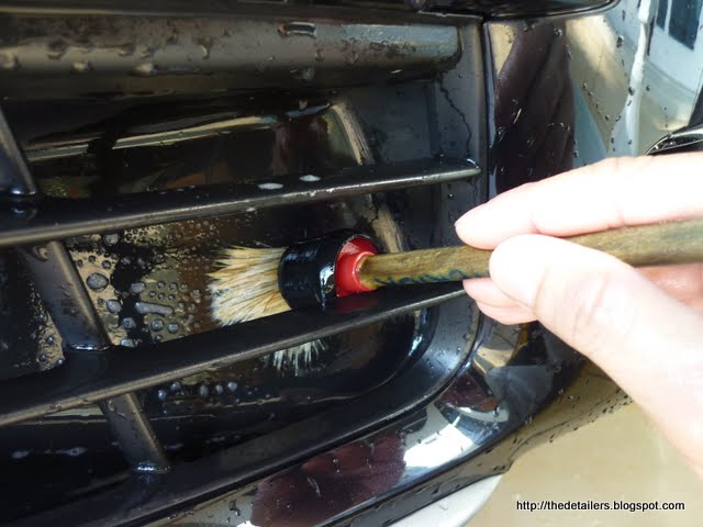

ONR wash it
if it is too dirty use
try Power clean dilute 1 : 5 part water
spray on the brush & aggitate prior rinsingoff
my buddy car

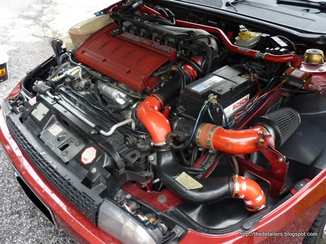

gsr-sam
Sep 10, 2005
96
PJ
Thanks bro...finally this is the method I used. Wash down with petrol..clean and rinse with Sunlight. Mine was really dirty and worn through the years. It works really well. But I must say that I was cautioned against this cleaning regularly. I only did it because mine was really bad.
