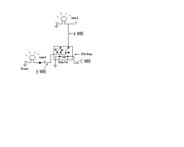

Just wanna do some project on my accord, wanna lightup blinkers with foglamp. Refer pic below, wanna blinker B to lightup when foglamp A is ON and at same time can blink when ON a signal. The colour line at pic show wire numbers and colour at each lamp.
Hope sifu here can brief me which wire to connect which wire to make this done. Thanks.

e-mad,thats not sound difficult..
1.1st,supply wire to A is paralled and the wire to B light is connected in NC (normally close) at 1pcs relay
2.the other end of that wire go to B light.
3.remember the ori supply wire to B light?conneted it to the relay coil.
4.that all bro..
i can gerenti u it can work..happy diy

step 1 until 3 just for one side.repeated it on the other side.sure can.

Bro..can draw some diagram ar?

spykey, I'm quiet blur on ur explaination....mayb u can use the colour wire that Ive draw coz I'm not very familiar with the wiring, but hv eger to try DIY...hehehe. Anyway, thanks alot 4 ur reply.

hi to all, i have done with the diagram+ explaination.
but do know how to attach.so pls provide me ur e mail..
tq
spykey
Dec 24, 2006
681
1
hi all,
here the diagram..
1.u get the item 1st like relay and some wire..
2.connected a new pararell wire from light A(shown as Wire A) and connect it to relay common contact.
3.Disconnect the original wire to light B.Reconnect it back at Relay supply wire/coil to energize it later.(shown as Wire C)
4.At the relay NC(normally close) contact,u connect the wire to the light B (shown as Wire B).
5.Then,all the negative polarity just connect to body.
ok,u have done it...
if still cant understand,consider urself a layman and go to shop to rewiring it.
anyway....happy DIY
