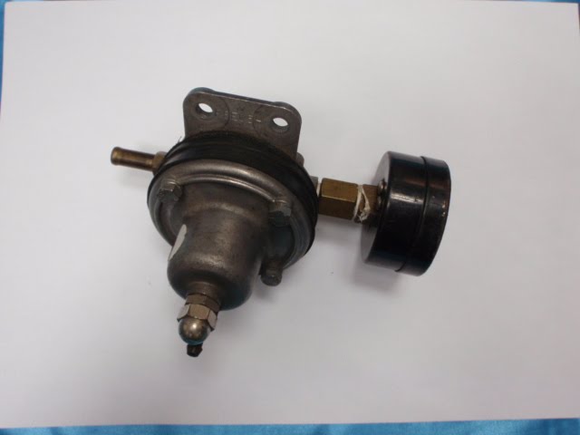

Can anyone advise on the difference between the 2 adjustable fuel regulators? Heard that FSE is supposed to be the better one....

i would not know about aerospeed fr but hav been using fse on my turbo engin for more than 5 yrs. for me it is more on the brand, price and recommendation from your friend.
in my opinion fse is more suitable on turbo engine as it used dual diafram to handle the extra fuel presure. my opinion can be bias as i'm using fse for some time. maybe u should inquire ppl who use aerospeed as well :)

Thanks bro.... heard that the Aerospeed one will not last as long as the FSE one... but usually, in the market, can a brand new FSE FR be bought?
What is the price like?

i wont support fse just becos its dual diagfram
the main purpose using fse its becos its rising rate 1:7 ratio i guess
it means more special on the turbo engine , every 1 psi increase in manifold , 7psi fuel will increase.
while arospeed n sard is 1:1 more suitable for lightly modded turbo n n/a cars

Thanks bro for the enlightenment. But would u say tht other than FSE, the rest will not last tht long/spoil easily?

no ler, see how many psi fuel pressure u want to set ler
if fse dual diag can high pressure,
sard small one lower pressure but enough for 2.0 turbo also
sard large on for higher pressure use
arospeed n sard small is around the same

Well, I was told by a mechanic tht if I use Arospeed or Sard, it would not be that lasting as compared to a FSE. This is because it will start to leak after sometime.
Wht is the price range for the FSE (new)? :biggrin:

at n1 sunway, they got fse fr...price is RM380 without meter...the meter only cost around RM50 to RM80...most of the otai told me that fse last longer than other brand...
juz check the price on monday...
