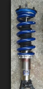

Hi,
My car having some problem , when go on uneven road or speed bumps , the car seems to be very bumpy/ rattle(even my dash board vibrates) but when on highway or smooth road its perfect. Using hwl hlsh adjustable absober but I recently noticed that I don't have the front top mounting for the aborbers , I have noticed some cars still use their oem top mount even though change to adjustable absorber, do I need this top mount installed?tq

Your suspension comes with pillow ball mount?

Not that sure, attached the picture, mine look exactly like that
Yup, looks like yours is minus the original top mount. If you want better ride then ask mechanic to fit them back on. Original top mount have rubber cushion
This is my suspension. The black thing right on top is the original top mount of the absorber...:driver:

Could be one of these:
- your top mount bearing has worn out. a replacement bearing will solve it for sure, if you have trouble locating the source, suspension makers can get it done for you. However some might require you to replace the entire mount to suit their design. Try Titan Suspension located somewhere near kota damansara.
- you have adjusted the height of the car recently. It might have been done wrongly. Some preload is required when setting the height of the coilovers. Preload provides the slight compression in the spring to keep it taut.
- worse case, your suspension needs a service.
