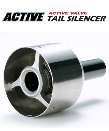

also can opt for this...or something similar...simple solution...2 in 1...closed when low pressure = silence... WOT high pressure valve opens = noisy...
or use the manual exhaust control valve via cable... like D7zul did...
Cool, does it really help? Where to get this and how much does it cost?
