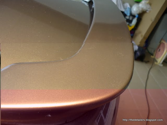

picture of the damage spoiler, BEFORE
Restore Picture
Extreme close up pic before correction
Picture after corrections, matrix picture…
Hope was restores…but that 1 foot of correction took me nearly 2 hours to restores . The most delicate detail I ever attempt thus far.
Tada the rear Ultimate look for this Machines

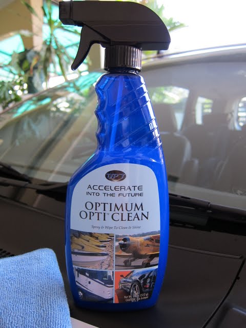

To my opinion, nothing lasts forever if no maintenance. Even with maintenance, it just slows down the process. Lets take for example the coating mostly talk in this forum... Optimum Opti Coat. Its a permanent coating sitting on top of the clear coat. Thicker than wax in microns(paint thickness). If left unmaintained then it will fail. For example you just got your car coated with any form of coating be it glass coating, quartz...etc. When you park your ride outside and you got bird poo/tree sap on paintwork, it must get removed as soon as you see it. Left untreated & it will etched into the coating & requires compounding/polishing for removal. Coating/waxes acts as a shield to slow down the etching. But it will still etched into the paintwork sooner or later. Best remove such contamination in less than 12 hours maximum.
I always keep a bottle of Optimum Opti Clean in my bag(can't store in car when parking in the sun or risk spoiling the product) & a microfiber cloth handy as I no longer practice the tissue+water technique. :biggrin:
After coating, your ride still needs to go through normal maintenance such as washing with pH Neutral shampoo, claying...etc.
The saying goes "Frequent car care is easy car care".
