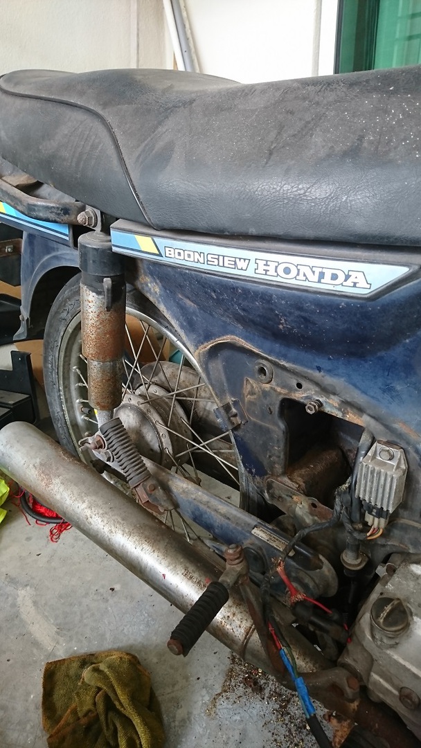

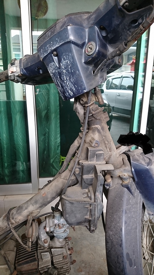

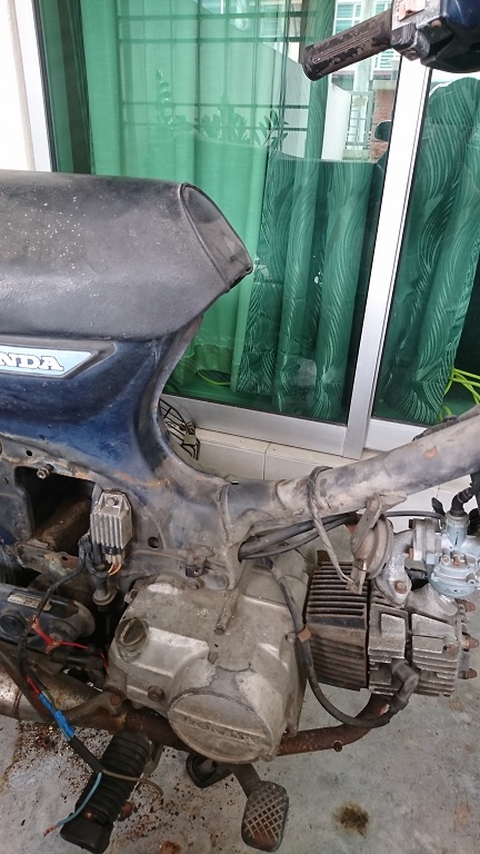

After 6 yrs stop riding my Ex5 to work and only start it to pusing taman only.
Totally forget to upkeep it for 1 and half yr. Result is worrying me.
Must take some action to bring it back to business. lol...DIY work not so beauty lah.
Here the condition when i open mudguard.
Battery compartment save on time. Scrap off rust , applied rust converter, spray high temp paint.

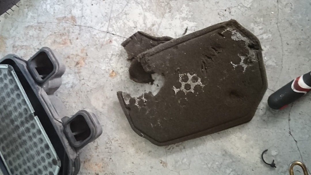

Air filter turn very brittle.
Replaced old spokes rim to tubeless sport rim. All back to business.
AAP sports rim + tires + bearing..etc install by shop. Bring back pasang jee...:biggrin:
Old carburetors replaced, will service old carb + new main jet, pilot jet.

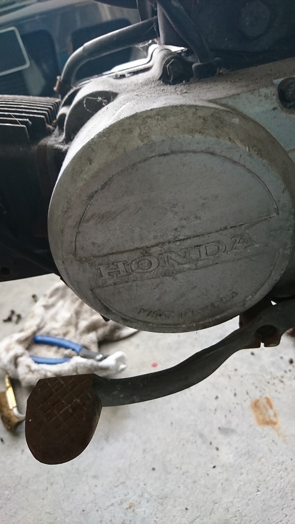

Cleaning, oil change, scrap off any rust, wipe off old dust...etc.
So is a temporary minor restoration to get my ex5 to move.
Alway reconnect the vapor hose from the bettery to dispersed out battery vapor outside the compartment. Its normal for the hose to be missin. u can use aquarium air hose.
So far from the picture its just surface dust so no worry. The sponge air filter is known to decayed and clogged the carb when no periodic maintenance is done. I just skit the sponge but kept the wire mesh.
U upgrade to sport rim just like what i did when i started to ride to work. Now i am itcy to go backwards by using spoke wheels modified to be tubeless. Been hearing mixed opinion and review in this conversion. This or gold colour 6 spoke aap wheels as my rear rim bearing hub is worn out, need to 'alas' the bearing for perfect fit.
Now mileage is 96k km. i will wait for it to be 100k km before deciding on engine service or minor upgrade. 53mm block with carb setting should be enough for daily ride.
