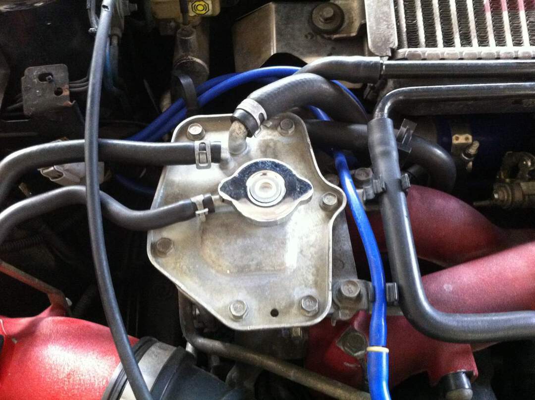

Just re-test again after engine cool down just now. same, without air-con water temp standard. with air-con on, water temp increast. And in reliaze some water burnt sound. May i know wat is this (Please refer attachment) TQ.

the water tank (photo) above is empty. just refill. just dont know why will be empty only.

Bro, just make sure both radiator and turbo reservoir have full water inside. The picture you shown (reservoir) must also have water inside and make it full.
The plastic reservoir besides the radiator must be in Full Level, follow the markings.
I have the same dilemma last year when i bought my STI ver 8, forgot to add water in the turbo reservoir tank and make my radiator leak and overheated.
