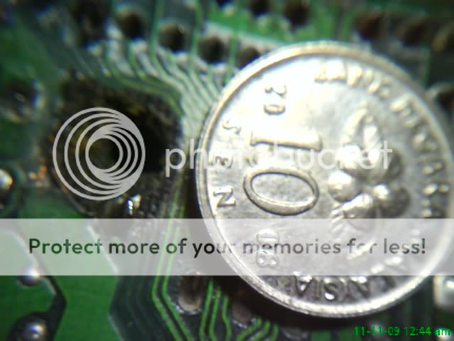

Guys...
this picture is the ecu that smoked after a customer balik kampung..was a P27
When reach his destination he smelled like something burning..
Finally he traced it to the ecu...
10 cents coin is for your reference of the hole size....TQ
