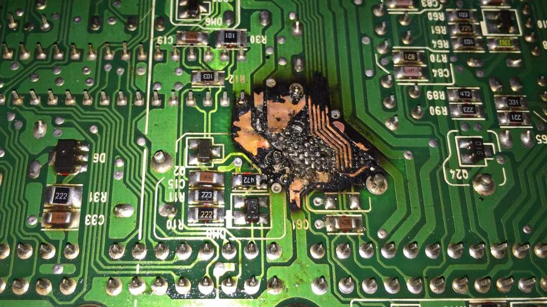

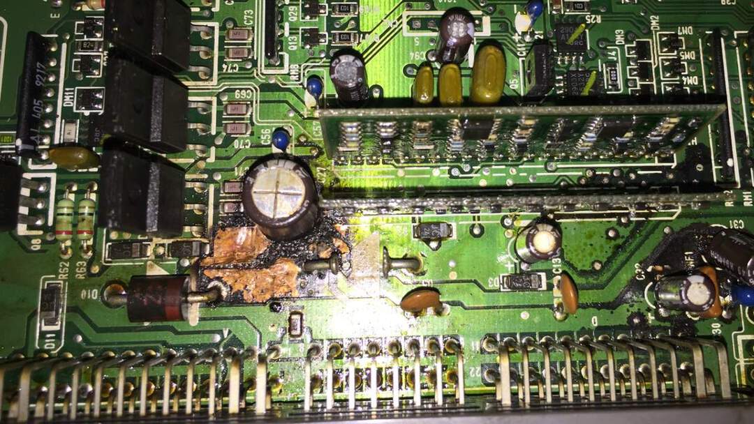

Have a look at this....
This ECU has a code 14, I swap the ECU and I am fine, there seems to be some water damage around the board but a lot of the transistors are hard to find.
I looked at your schematic earlier and noticed Q45 is part of the IACV components, it does not look bad. Can you tell me if any of the damaged parts have to do with IACV
Hi...
Your ecu still looks good.
Change the 8 pcs of capacitors should solve your problem.
