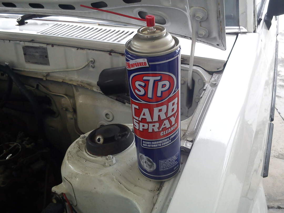

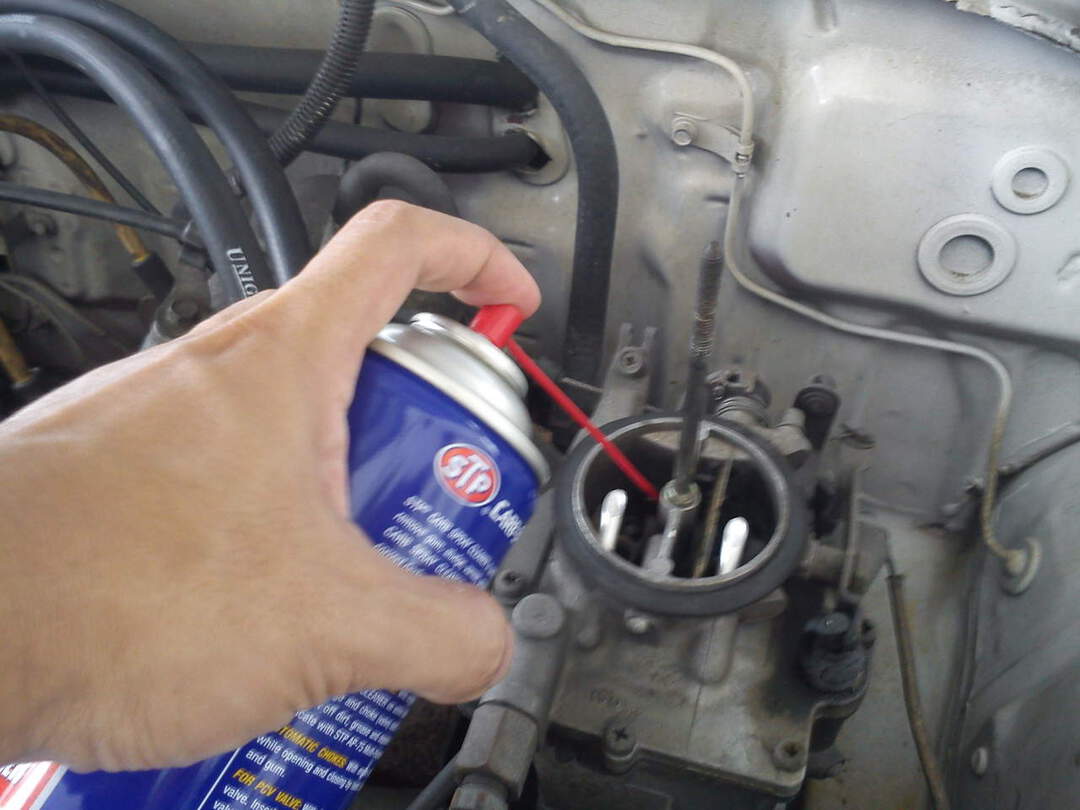

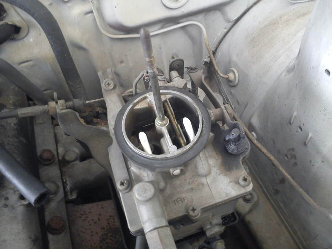

update..
done my 'cleaning'.. not as thoroughly as Izso did.. but ok la..
buy a can of STP Carb Cleaner.. and follow instruction on d can..
pictures enclosed..

regard the second and third picture from D7zul, may i know what is the 2 sharp rod which looks like the sharp edge of a drinking straw are for? Wonder what is it use for and where it leads to? Can i spray carb cleaner into it?
D7zul
2,000 RPM
Feb 24, 2011
2,697
848
1,713
Shah Alam
not sure what those rods are for.. there are similar rods further down the carb & it supply fuel to d engine..
i only spray at places that's with oil stain.. the rods are sweaky clean.. so, i don't bother to spray on it :biggrin:
