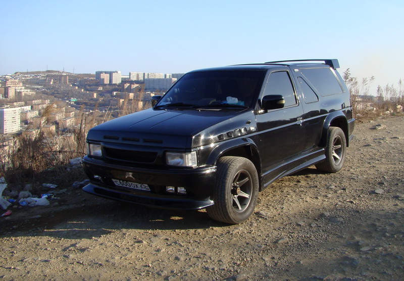

salam 1 kangkung
i'm planning to buy used nissan terrano and change into sr20det auto
but terrano weight will make this engine struggle
terrano weight= 1540 kg - 4x4 system about 100 kg =1440 kg curb weight
nissan silvia = 1200 -1300 kg
my question is;
is that possibble to detuning sr20det to get low end power ?high torque at lower rpm
need to change turbo n intercooler system?
or this suggestion is impossible to implement?
i'm not speed demon ,just need for daily drive
