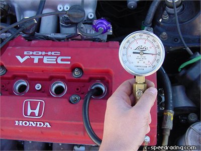

my problems are retainer and spring still std type R, compression 12.3 -12 -12 - 14.5 only, need to change high comp pistons, and the pomen recommend s300 for management... so i think just want to downgrade, pro3 to b16b cam.... izzit plug and play? how to fix the compression issue?:hmmmm:
"compression 12.3 -12 -12 - 14.5 only" - wat meaning this? u did a compression leak down test? wats the psi? compression leak down only tells u ur cylinder pressure and whether or not its healthy or if there is any leaks via cracks, bad valve seats, worn out piston rings, etc. ur gonna have to open it up and identify the problem first before fixing.
it wont tell u ur compression ratio.
can change valve springs to supertech... RM550 brand new. thats if u plan on keeping the pro3 la
