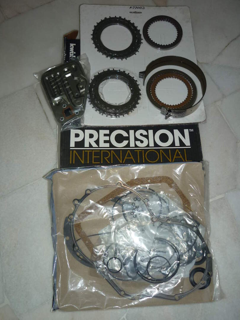

Just to show you the rebuild kit that I will use for this job. It's from Precision International (USA) @ RM550. It's a master kit, which means it includes all metals and brake band.
