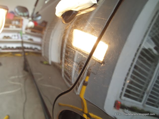

allow me to show you
wow - what a reflection - MIRROR SHINING -
Mirror shining ?????? Really ke
ta da - lets see the truth - pls do not be blind by my pics - as many would gives u a pictures & not the whole picture
let see
another reflective picture - wow better than mirror
oppsssssss...........yes when it is with proper lighting - truth will be reveal

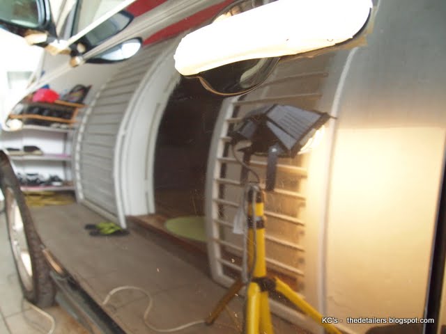

now you what i did was - onr wash the car
Clay with onr as lube
Polish with ROTARY - compound with Lake country wool with optimum Hyper Compound, cut with lake country CCS yellow Cutting pad with Optimum hyper compound & Polish with polishing pad & optimum Hyper spray polish & finish with LC CCS Purple pad with optimum Hyper spray polish
results
a great make over & ta da
check out the lighting now
Mirror shining -

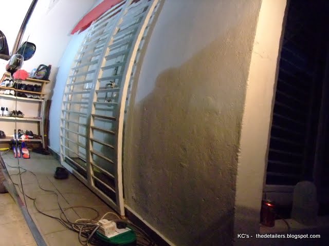

the bigger pic
only 1 layer of OPTI Seal, spray & spread & walk away
OPTIMUM car wax spray & wipe & walk away
