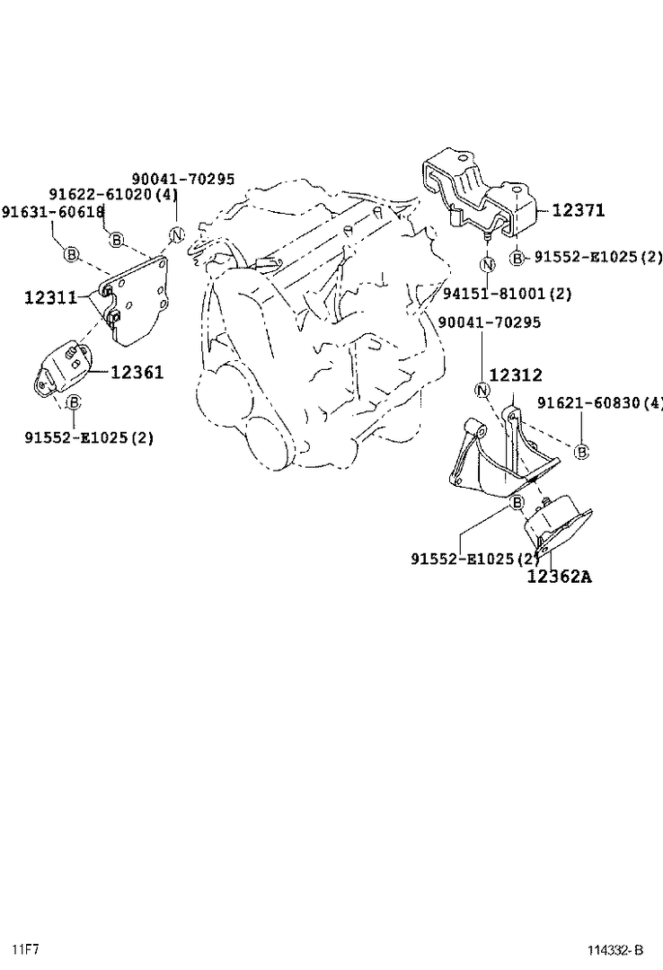

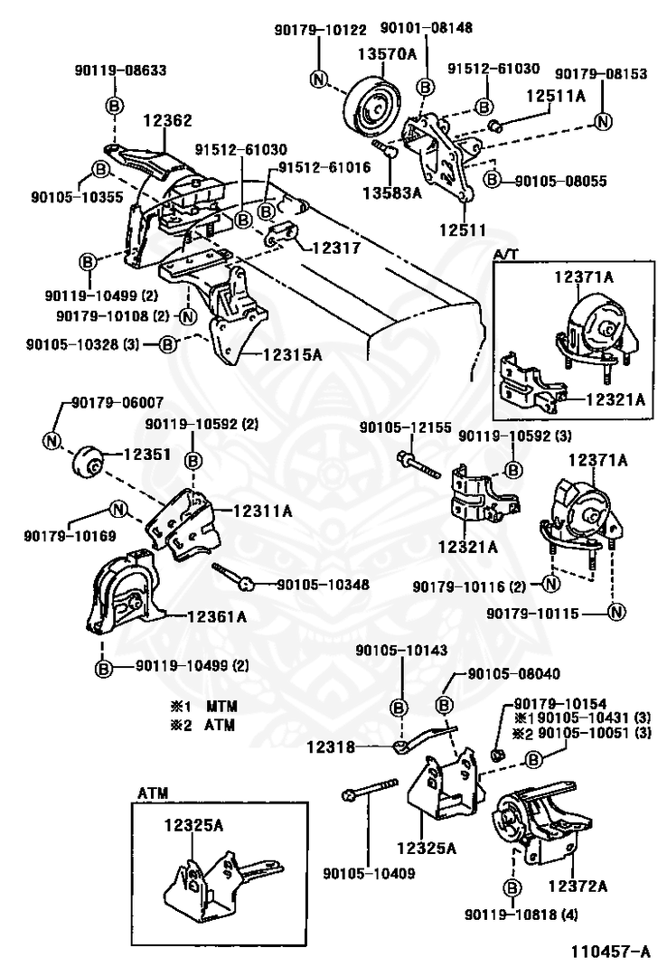

Alza engine mounting
4AGE mounting. I think the mounting locations are way too different to be legal.
