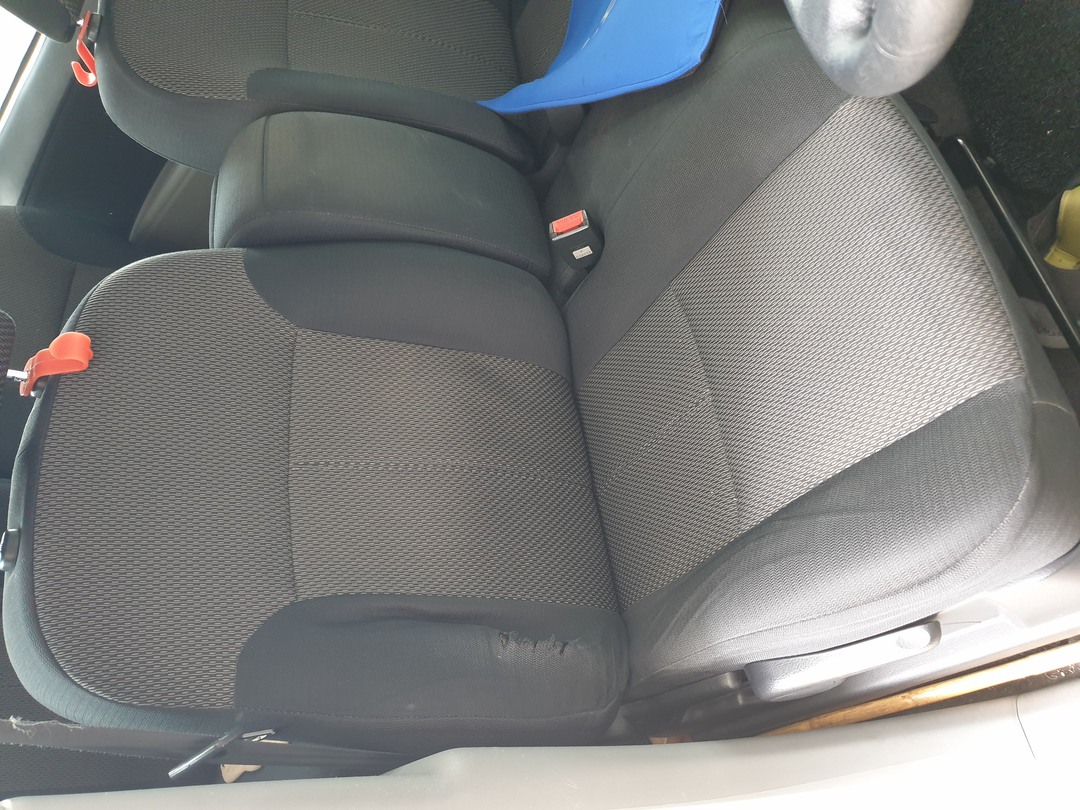

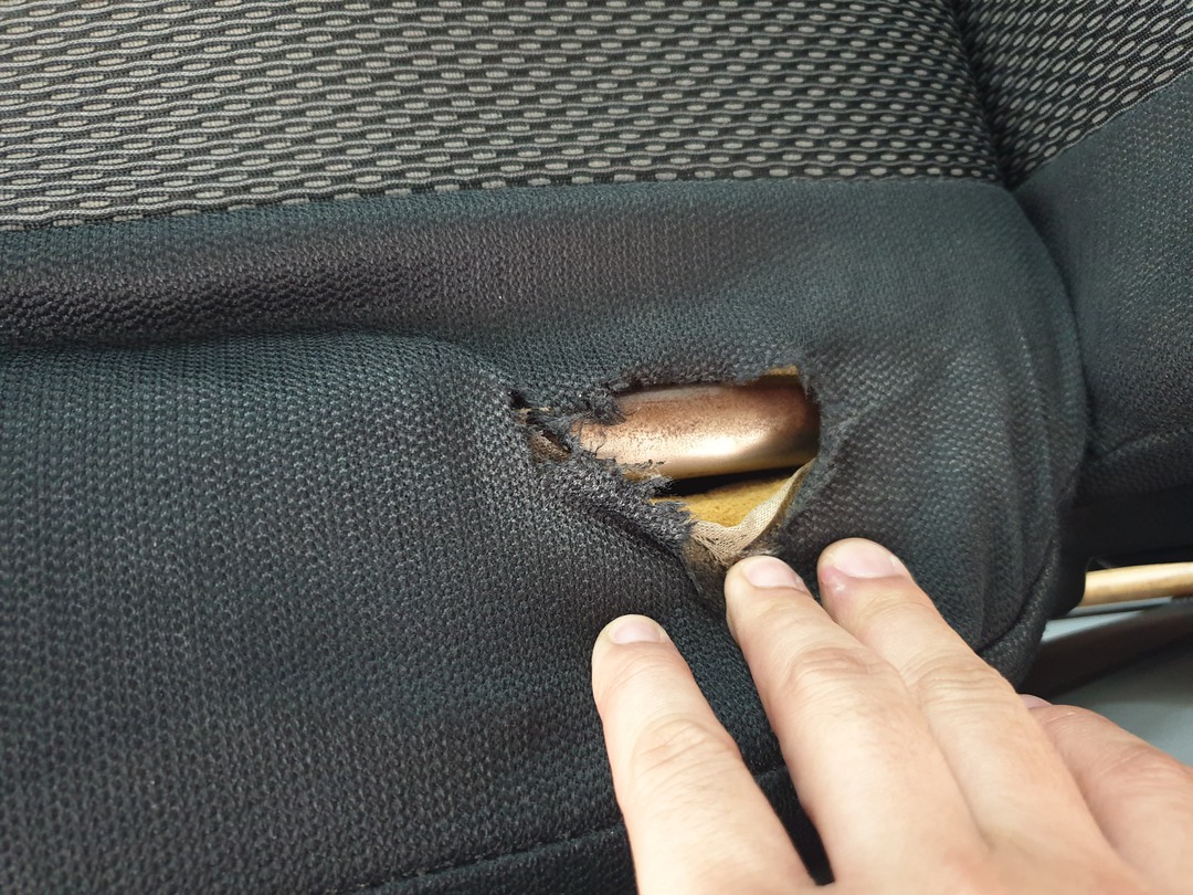

Hi,
My 8 years old Alza been serving me well except coming to 9 years with 170K mileage, there is a need to put in some effort and money in the maintenance.
Do you know where can I get my driver side seat with squeaky sound and worn out fabric fixed. See attach photo.
Thanks in advance

squeaky sound can be solved by buying new bush and spring. @ SC it cost rm200 below for 4 springs and bushes include installation
Went to one of the SC in USJ 19, they told me need to change the entire seat, instead of repairing the bush only. :(

You can try Steady Cushion Trading in Petaling Jaya. They can fill back the foam but you may need new covers for the cushion, and this may cost more. If you can find your seat from half cut shop, they are just plug and play.....
Repair will do. Last time replace covers +added padding for wira whole set. 450 bucks.
Those cushion/seat man know what to do.
Give him two options. I have done seat repair and also did seat swap before.......lol

otherwise just buy a couple of T-shirts, cut it up and make a seat cover out of them. :biggrin:
Last time I did not even cut, cover up, then fold the sleeves in......lol
But bottom torn cannot loh, only top half.....
