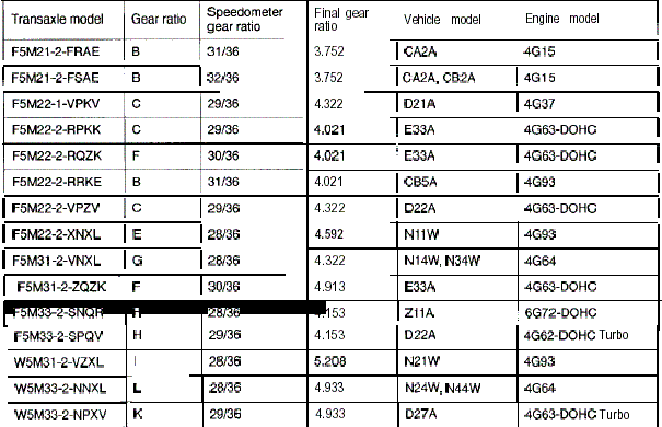

Hi Yee,
Cheers for the info and the pic,
Very well great indeed!! :wavey:
me code is:F5M222-RRKE
this gb not with LSD but, im tend to fix the LSD in the future,
just need to know if this is compatible?
also the pomen said this is 4g93 1.8 gb! but does it go along with 4g92 1.6 mivec?
will i get the top speed and pick up?
cheers:driver:

Anton Lavey
modesto007: yeah the 1.8 gb is compatible with ur mivec engine, cos it's from the same- 4G9x series family. Besides, i believe there are some after market LSD available for sale(try to ask around) in kl. Mivec gb has a shorter ratio (good in acceleration) while 4g93 gb has longer ratio(higher top speed).
I think if u ask around the mivec owners here, they would encourage u to go for a mivec gb :P
