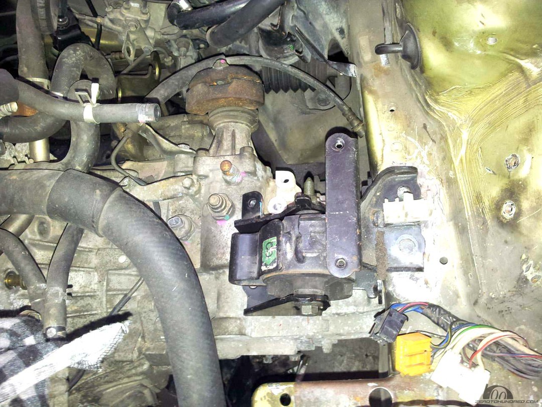

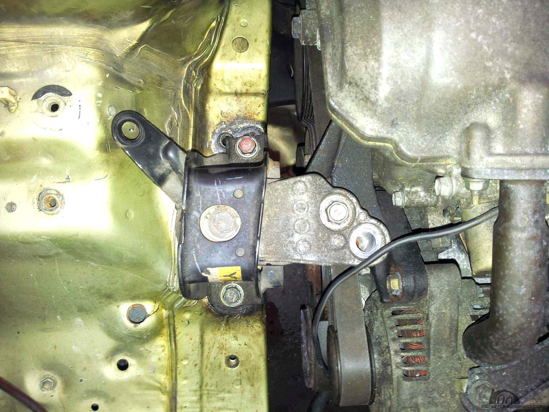

I remember someone uploaded these photos
My question is is this a 2zzge mount and bracket?
What mount and bracket are these?
What did you do?
The firewall side is quite high when we put the 2zzge engine stock mount and bracket. We tried the 1zz mount and bracket it is still far from placing the locks for the bracket.
The 3rd photo is mine though.
Thanks.

Try using the existing engine mount but custom a bride mount across.
