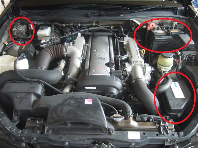

Doing some research on Altezza, which is the most suitable 1JZ vvti halfcut for Altezza?

According to my research, ABS pump, ECU & battery position is different from altezza.
Altezza's ABS have 2 types, I would prefer to use back the JZX100's ABS but its located at the other side of the engine bay.

Great to know that, I need more info on 1JZ. Actually I've already done the conversion, but its a 1JZ-FSE. Now planing to smack in a manual gbox.

According to my research, I think the JZX110 is more suitable, but the major problem is no one actually brings in. Too new & expensive I reckon.

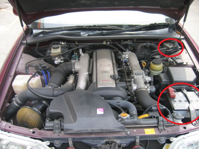

But I've discovered there are few things JZX110 & SXE10 share in common, such as:
- ABS pump
- Battery
- ECU
As for JZX100 ECU located inside the dash, unlike the JZX110 ECU position is just plug & play.
I might be wrong, but do correct me if i'm wrong.
Please refer to the picture below.

your pictures showing 1JZ-GTE and not 1JZ-FSE.
1JZ-FSE is the 'economy' version (eg.3SG v 3SF)
